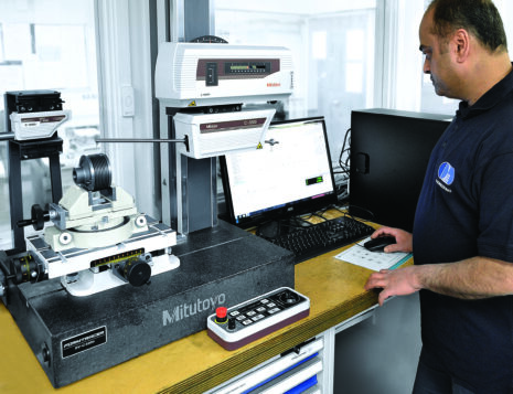

Tim Bainbridge continued. “We recently won a contract that involved the manufacture of precision shafts that had extremely demanding dimensional specifications. In particular, the lead angle of the shafts’ chamfers that entered mating parts, needed to be held to 30 degrees with an extremely tight tolerance. As we needed more confidence in the results we were achieving with our optical comparator, and because of our growing need for a highly precise means of measuring components’ form, contour and surface roughness, we searched for a suitable solution.”
“Having looked at a couple of alternative systems, a demonstration of Mitutoyo’s Formtracer SV-C3200 instrument, conducted on both our problematic shafts, and on a wide range of other challenging applications, persuaded us that the unit was ideal for our use.”
“Now installed and fully operational, our quality personnel have had their initial product training. As the machine’s controls and software is relatively intuitive and easy to follow, we are already undertaking a lot fairly involved form, contour and surface roughness inspection and achieving very accurate results. A second planned training session should enable our staff to quickly become fully proficient in the Formtracer SV-C3200’s use. Given the ever-increasing complexity of the parts we produce, in addition to improving the precision of our form, contour and surface roughness checks, it also helps that our new Mitutoyo instrument completes its routines extremely quickly. The speed of the Formtracer SV-C3200 has removed the potential for inspection department bottlenecks in these vital areas, and has enabled us to forward inspected components to dispatch much quicker.”
Mitutoyo offers a wide range of high-quality, flexible measuring instruments that enable high-accuracy measurement of form/contour and surface roughness with just a single unit. The Mitutoyo Formtracer SV( 3200 boasts excellent traverse straightness making it suitable for handling workpieces calling for high accuracy. In addition to providing high-precision results, the Formtracer SV-C3200’s increased drive speed (X1 axis: 80mm/s, Z2 axis column: 20mm/s) substantially reduces measurement cycle measurement times.
The Formtracer SV-C3200’s drive unit (X1 axis) and column (Z2 axis) are equipped with precise linear encoders (ABS type on the Z2 axis). This technology improves the reproducibility of continuous automatic measurement of small holes in the vertical direction and repeated measurement of parts which are difficult to position. Also, highly rigid ceramic guides, combining small secular change and high resistance to abrasion, help to maintain traverse linearity specification over an extended period of time.
