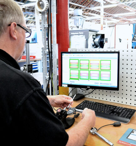

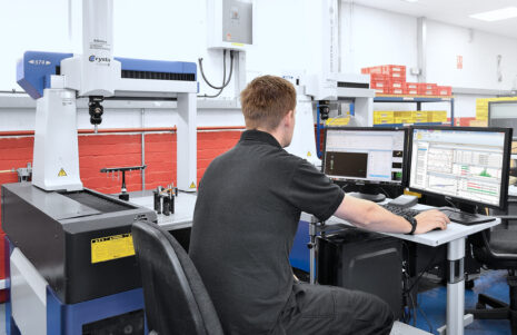

Prompted by the early success of the original MeasurLink software, further suites were soon added. The company’s latest purchase means that Merc Aerospace now use six MeasurLink software suites that are fully networked. Five suites serve measuring stations that are strategically located across the company’s production departments and used by production operatives. In addition, one suite is employed collecting data from a Coordinate Measuring Machine (CMM).
In addition to having an industrial PC loaded with MeasurLink software, each shop-floor measuring station is equipped with a collection of Mitutoyo digital measuring instruments, such as micrometers, calipers, bore gauges and height gauges. To help ensure that machine operators’ inspection and data acquisition tasks can be performed within machine tool cycle times, rather than use unwieldly cables, Merc Aerospace have adopted progressive wireless transmission techniques to down-load each gauge’s findings to MeasurLink software.

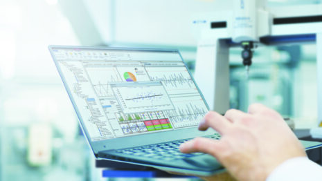

A typical routine whilst measuring a feature on a component would be, the press of an instrument’s button would wirelessly send a measuring result to the software. In addition to an easy to understand graphic image, the numeric value of the feature’s size would be instantly displayed on the workstation’s PC. If the presented dimension had drifted from the specified nominal size, the operator would make the necessary machine adjustments. Also, as each of Merc Aerospace’s suites of MeasurLink software are fully networked, all of the obtained inspection data is immediately downloaded to the company’s Quality Department for analysis.

As a client/server application, Mitutoyo’s MeasurLink software provides users with the performance they need through distributed processing. Combined with a multi-user relational database, MeasurLink delivers a safe and organised data warehousing system making quality data available for viewing and analysis by a company’s production, engineering and managerial staff.
MeasurLink is capable of linking and managing multiple ‘islands’ of inspection into a common database of part information, statistical data, gauge information, process, etc. Information is shared across an entire manufacturing facility. Inspection in the factory produces data for analysis, corrective action, and various reporting needs. As the backbone of users’ quality efforts, MeasurLink is guaranteed to reduce production costs and increase business’ profitability. MeasurLink is available in several modules offering a wide range of solutions, from data acquisition to manager views and gauge management.
