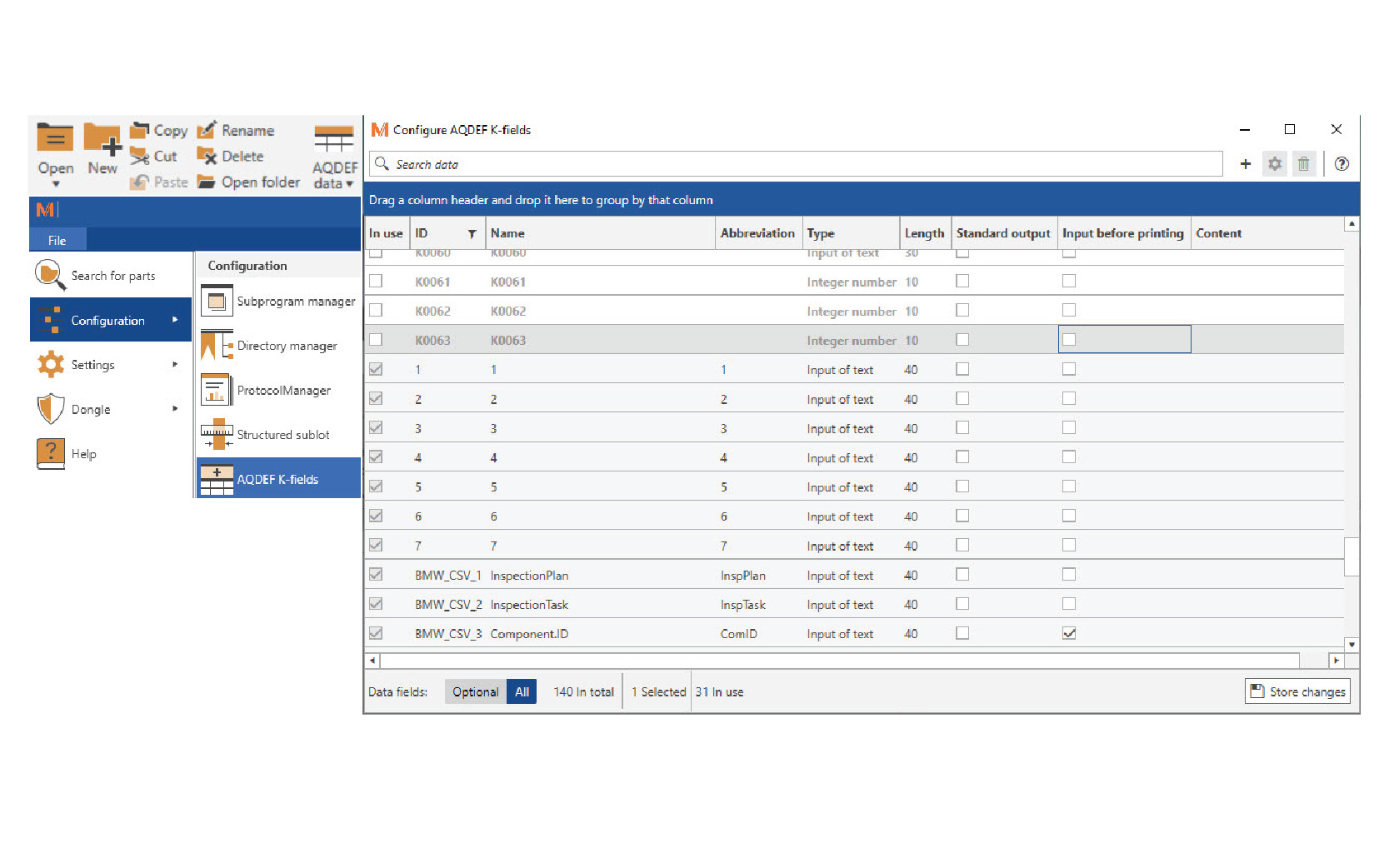

AQDEF® Support
Advanced Quality Data Exchange Format is an extended quality data exchange format for standardized data exchange between length measuring devices and standard tools for statistical evaluation such as qs-STAT von Q-DAS.

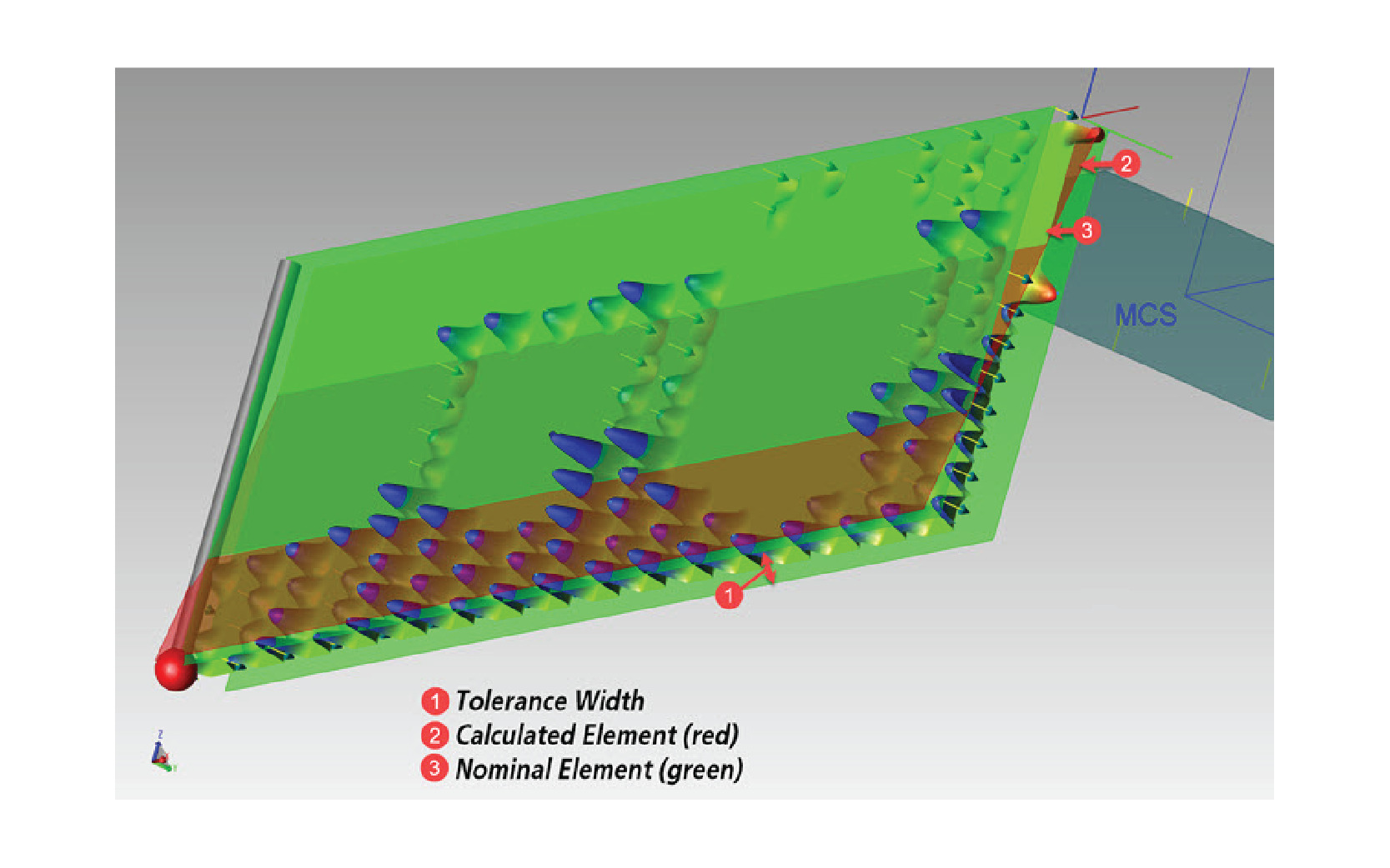

3D Perpendicularity Support
Powerful graphics help visualize the directional tolerance perpendicularity of a plane relation to different reference features (plane, axis of cylinder, axis of cone).

Data Recording Standardized
AQDEF was developed based on the Q-DAS ASCII transfer format. The Q-DAS ASCII transfer format defines how information about measured parts and their environment (machines, operators) is exchanged between different measuring systems.
Easily Define Required Fields
AQDEF is a list of data fields, so-called K-fields with which each piece of information can be clearly assigned. There are mandatory K-fields (status 1) and optional K-fields (status 2). In addition to the mandatory K-fields, it is possible to define which of the optional K-fields are required for all part programs (global configuration).

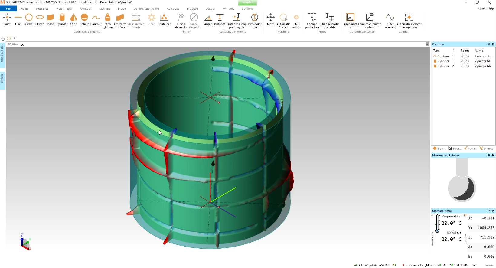

Fast, Efficient, Easy-to-Use CMM Software
MCOSMOS is Mitutoyo’s proprietary metrology suite of interrelated modules and dedicated expansion modules for Microsoft Windows 10 and 11 operating systems. Available in 37 countries and 12 different languages, MCOSMOS sets the world’s standard for metrology software.
MCOSMOS allows for integration among a whole series of applications, improving the efficiency of your CMM and bringing greater productivity to your quality control functions. Expansion modules such as GEOPAK are available for specific applications including gear measurement, airfoil analysis, reverse engineering and integrating CAD with metrology.
The modular MCOSMOS system gives you the ability to tailor your measuring software so that it includes only the specific modules needed to meet requirements. Measurement results may be displayed, printed and archived with numerous built-in and user-defined formats.

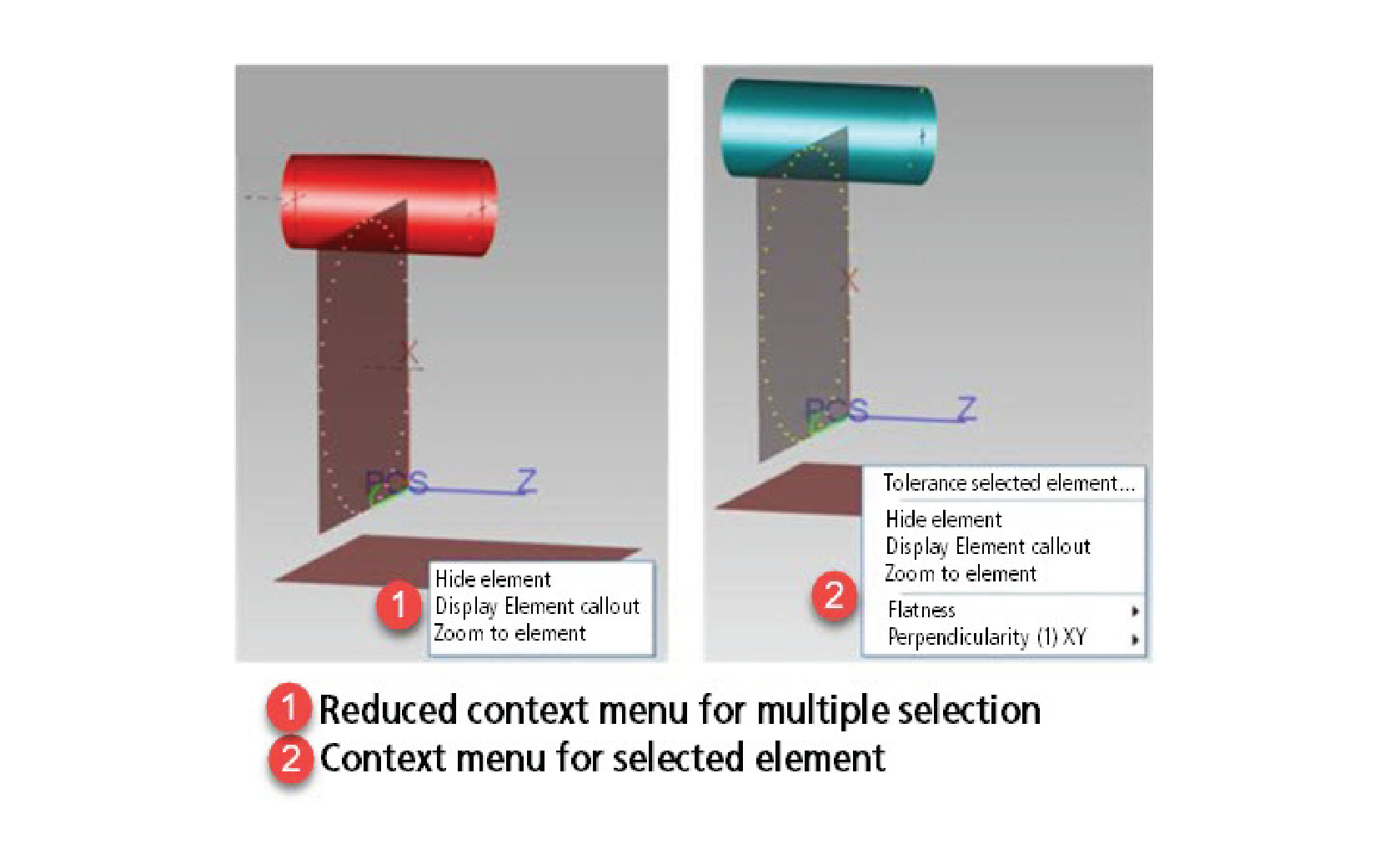

New 3D View Menus
If several elements have been selected in the 3D View, a reduced context menu is available. This context menu includes the actions that can be carried out for all selected elements. This saves time because the actions do not have to be carried out for each element individually.
