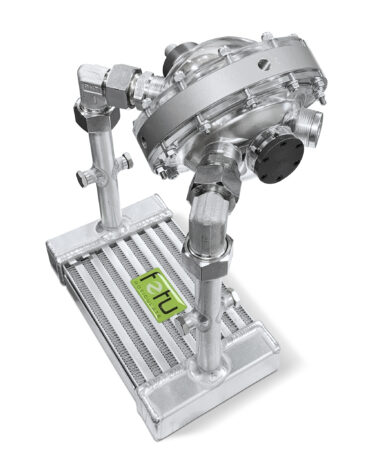

Established in 2016, FeTu Ltd is an innovation driven enterprise that has developed a revolutionary ‘green’ energy device that targets carbon reductions across a broad range of systems and industries. FeTu’s disruptive technology is a versatile ‘continuous positive displacement’ machine that is suitable for a wide range of applications.
The Elland, West Yorkshire based company’s lightweight and scalable technology uses just two moving parts to operate four anti-phased compression chambers and offers low-loss conversion from potential to kinetic energy.
As a relatively young dynamic business that is involved in the design, development and testing of its ‘roticulating’ technology, FeTu currently subcontracts all of its manufacturing activities. Given the extremely demanding dimensional tolerances and the critical geometries of the device’s two moving parts, FeTu Founder and CEO, Jon Fenton recently searched for a source of independent, high-precision inspection. The answer to FeTu’s precision inspection needs was found in Mitutoyo’s Measurement Services.

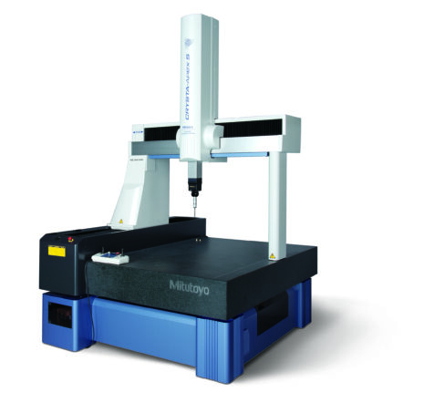

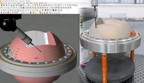

Prior to the assembly and testing of each new iteration of FeTu’s designs, having previously written the required CMM software programs, Mitutoyo’s staff use one of the company’s advanced CRYSTA-Apex S Series CNC coordinate measuring machines to perform a range of in-depth, high-precision inspection routines on FeTu’s components. Following each CMM inspection routine comprehensive inspection reports are generated and supplied to FeTu allowing further developments to take place.
FeTu’s association with Mitutoyo’s Measurement Services Department has resulted in a range of tangible benefits. FeTu Founder and CEO, Jon Fenton explained. “As tradition has it, in visualizing an ‘engine’, ‘pump’, ‘compressor’, ‘turbine’ or ‘expander’; we imagine five discreet machines which all appear and function in very different ways. The beauty of our unique technology is that it is able to accomplish each of these functions in a much more efficient way than they are performed by current, traditional technology.”
“The two dynamic parts of the FeTu system do not make contact but run so close to each other as to make an effective a seal. The sealing effect is aided by the leakage path lengths being so long that they stagnate flow. To ensure that an efficient seal is achieved, the system’s high precision moving parts have extremely tight dimensional tolerances. Therefore, a major aspect of our design, development and testing activities has been achieving the required levels of accuracy that allows efficient and reliable sealing to be accomplished.”

“Having liaised with Jon Fenton of FeTu, we concluded that the use of an advanced MitutoyoCRYSTA-Apex S Series CMM was the ideal means of achieving the required levels of precision and the speed of feedback needed. Also, given the CMM’s use of Mitutoyo’s MCOSMOS software we were able to create customised and detailed inspection reports that met FeTu’s demanding needs.”
